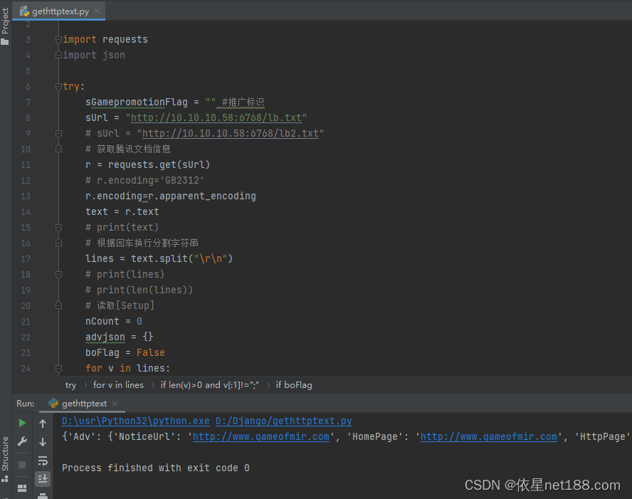

通过http读取此列表内容,然后分解解析为JSON格式,以例更好的使用。解析后的内容如下:
{"Adv":"{"NoticeUrl":"http://www.gameofmir.com","HttpPage":"http://www.xxx.com","HomePage":"http://www.xxx.com","boAuto":"FALSE","AutoTime":"360","Caption":"电信服务器","FilePath":"传奇归来7000","ServerName":"传奇归来7000"}","List","[{"TitleColor":"电信服务器/254","UpdateAddr":"127.0.0.1","UpdatePort":"0","Caption":"热血传奇7008/250","ServerName":"传奇归来7008","ServerAddr":"127.0.0.1","ServerPort":"7012"},{"TitleColor":"电信服务器/254","UpdateAddr":"127.0.0.1","UpdatePort":"0","Caption":"传奇归来7000/251","ServerName":"传奇归来7000","ServerAddr":"127.0.0.1","ServerPort":"7012"},{"TitleColor":"网通服务器/249","UpdateAddr":"127.0.0.1","UpdatePort":"0","Caption":"热血传奇7008/252","ServerName":"传奇归来7008","ServerAddr":"127.0.0.1","ServerPort":"7012"},{"TitleColor":"网通服务器/249","UpdateAddr":"127.0.0.1","UpdatePort":"0","Caption":"传奇归来7000/253","ServerName":"传奇归来7000","ServerAddr":"127.0.0.1","ServerPort":"7012"},{"TitleColor":"电信服务器/254","UpdateAddr":"127.0.0.1","UpdatePort":"0","Caption":"热血传奇7008/250","ServerName":"传奇归来7008","ServerAddr":"127.0.0.1","ServerPort":"7012"},{"TitleColor":"电信服务器/254","UpdateAddr":"127.0.0.1","UpdatePort":"0","Caption":"传奇归来7000/251","ServerName":"传奇归来7000","ServerAddr":"127.0.0.1","ServerPort":"7012"},{"TitleColor":"网通服务器/249","UpdateAddr":"127.0.0.1","UpdatePort":"0","Caption":"热血传奇7008/252","ServerName":"传奇归来7008","ServerAddr":"127.0.0.1","ServerPort":"7012"},{"TitleColor":"网通服务器/249","UpdateAddr":"127.0.0.1","UpdatePort":"0","Caption":"传奇归来7000/253","ServerName":"传奇归来7000","ServerAddr":"127.0.0.1","ServerPort":"7012"},{"TitleColor":"双线服务器","UpdateAddr":"127.0.0.1","UpdatePort":"0","Caption":"热血传奇7008","ServerName":"传奇归来7008","ServerAddr":"127.0.0.1","ServerPort":"7008"},{"TitleColor":"双线服务器","UpdateAddr":"127.0.0.1","UpdatePort":"0","Caption":"传奇归来7000","ServerName":"传奇归来7000","ServerAddr":"127.0.0.1","ServerPort":"7000"},{"TitleColor":"双线服务器","UpdateAddr":"127.0.0.1","UpdatePort":"0","Caption":"热血传奇7008","ServerName":"传奇归来7008","ServerAddr":"127.0.0.1","ServerPort":"7008"},{"TitleColor":"双线服务器","UpdateAddr":"127.0.0.1","UpdatePort":"0","Caption":"传奇归来7000","ServerName":"传奇归来7000","ServerAddr":"127.0.0.1","ServerPort":"7000"}]"}
源码运行截图如下:
